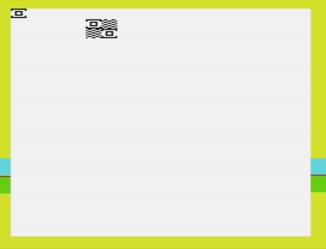

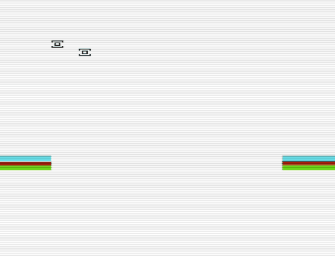

A core requirement will of course be sprites. I'm implementing two very easy to use sprite routines (an 8x8 and a 16x16) which will cover most use cases, but also a option to create sprites up to the size of the screen should you wish to. Sprite drawing can be done in OR, EOR or AND modes, the latter useful for 'cutting out' from the background or if you wish to have a masked sprite.
Here's a simple 8x8 sprite. The colour banding is how much time it is taking to clear (cyan), position (red) and draw (green), so it should be fast enough to have many sprites on screen.
Click to view animation

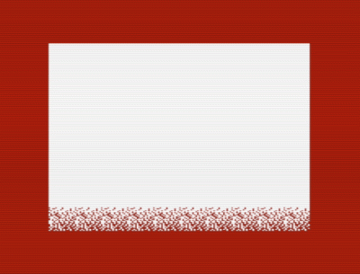

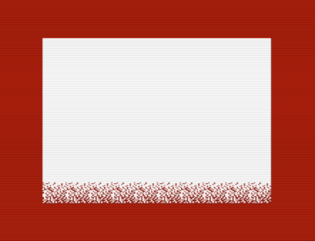

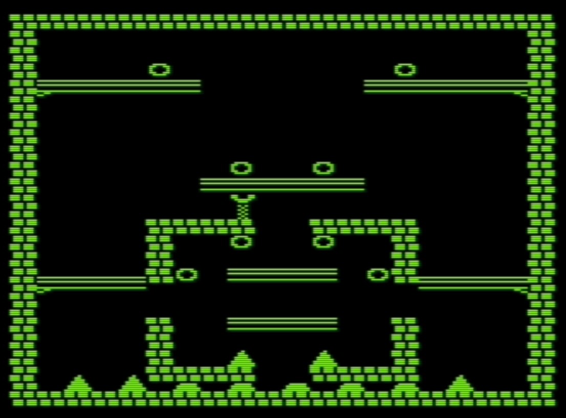

Today I implemented a command called which will allow you to quickly draw a tilemap of character data to the bitmap of any size up to the size of the screen.
The above image shows two tilemaps drawn - the first a full screen map and the second a smaller 10x10 map near the bottom overlaying the previous. The draw current mode is replace, but like the support for drawing single 'tiles', I will add EOR, OR and AND support too.

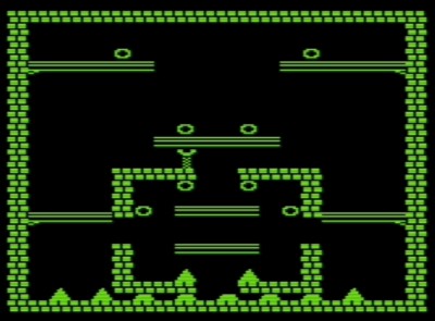

Prior to Christmas I also finished the sprite routines. Here is a 16x16 pre-shifted sprite:
Sprite support comes with easy to use commands for 8x8 or 16x16 sprites, but with 'sprite slices' you can make sprites as big as memory and the screen will allow. You can also draw sprites with OR, EOR or AND.
Next up is Text support, then displaying BCD numbers and finally simple pixel collision testing.
vbmDrawTileMap( map, chars, x1, y1, x2, y2 )

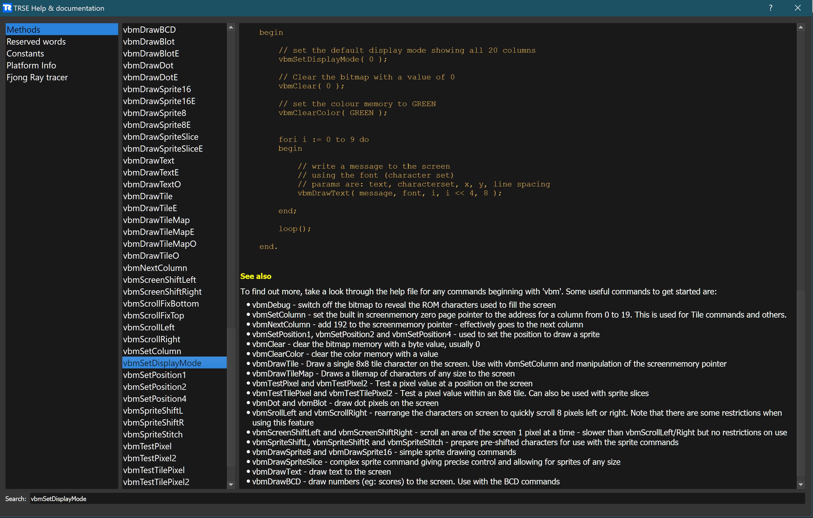

Here's a peek at the first help file and some of the commands available.
Next up is documentation and an example project showing how to use the various commands. Then there will be lots of testing to do, which will likely be via a beta period for anyone who is interesting in helping with this.

Here is a summary of the commandset:
The draw commands generally have variants for Replace, Or, EOR and AND drawing operations.
My design approach with this commandset is to provide the essentials for doing what you would need in a game. It will still be up to the programmer to decide how they use them so there is flexibility there to do as you wish. For example, I do not implement a sprite manager for handling when to draw and clear sprites to avoid or minimise flicker - but the tools are there (hopefully) to allow you to do that.
There is surely more things I can add to my Vic Bitmap Mode, and I will do over time. Collision routines for sprites and tiles, lines, ellipses and fills for example. Perhaps I can persuade the guys behind the Minigrafik and new frontiers to help me with some code to do that
I'll post more updates soon, probably the mini game initially and the beta release of the VBM commandset within Turbo Rascal (as Nicolaas is eager to do another release in the next month or so). I'm sure I will have bugs to fix, hopefully catch many of these with the development of my mini-game.
- vbmDebug - switch off the bitmap to reveal the ROM characters used to fill the screen
- vbmSetColumn - set the built in screenmemory zero page pointer to the address for a column from 0 to 19. This is used for Tile commands and others.
- vbmNextColumn - add 192 to the screenmemory pointer - effectively goes to the next column
- vbmSetPosition1, vbmSetPosition2 and vbmSetPosition4 - used to set the position to draw a sprite
- vbmClear - clear the bitmap memory with a byte value, usually 0
- vbmClearColor - clear the color memory with a value
- vbmDrawTile - Draw a single 8x8 tile character on the screen. Use with vbmSetColumn and manipulation of the screenmemory pointer
- vbmDrawTileMap - Draws a tilemap of characters of any size to the screen
- vbmTestPixel and vbmTestPixel2 - Test a pixel value at a position on the screen
- vbmTestTilePixel and vbmTestTilePixel2 - Test a pixel value within an 8x8 tile. Can also be used with sprite slices
- vbmDot and vbmBlot - draw dot pixels on the screen
- vbmSrollLeft and vbmScrollRight - rearrange the characters on screen to quickly scroll 8 pixels left or right. Note that there are some restrictions when using this feature
- vbmScreenShiftLeft and vbmScreenShiftRight - scroll an area of the screen 1 pixel at a time - slower than vbmScrollLeft/Right but no restrictions on use
- vbmSpriteShiftL, vbmSpriteShiftR and vbmSpriteStitch - prepare pre-shifted characters for use with the sprite commands
- vbmDrawSprite8 and vbmDrawSprite16 - simple sprite drawing commands
- vbmDrawSpriteSlice - complex sprite command giving precise control and allowing for sprites of any size
- vbmDrawText - draw text to the screen
- vbmDrawBCD - draw numbers (eg: scores) to the screen. Use with the BCD commands
