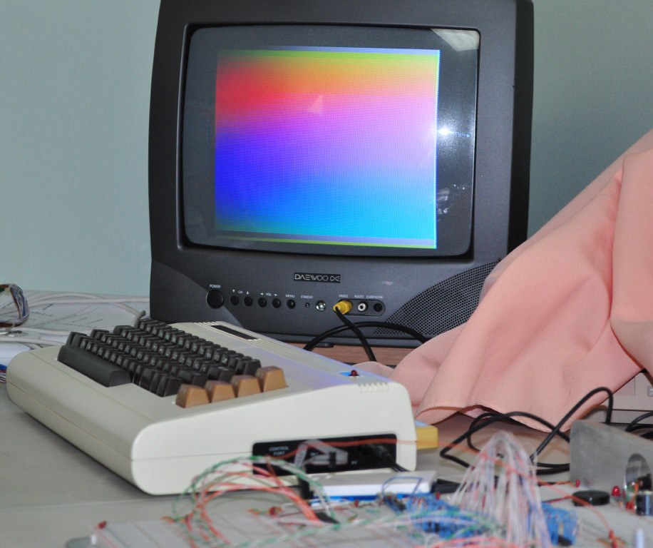

First demo will be VIC-20 Basic doing 100% smooth 60FPS over-scanned scrolling of a massive (4096 x 4096 bitmap) 256 color game screen in all directions, with single pixel resolution... something that Amiga can only dream of doing!

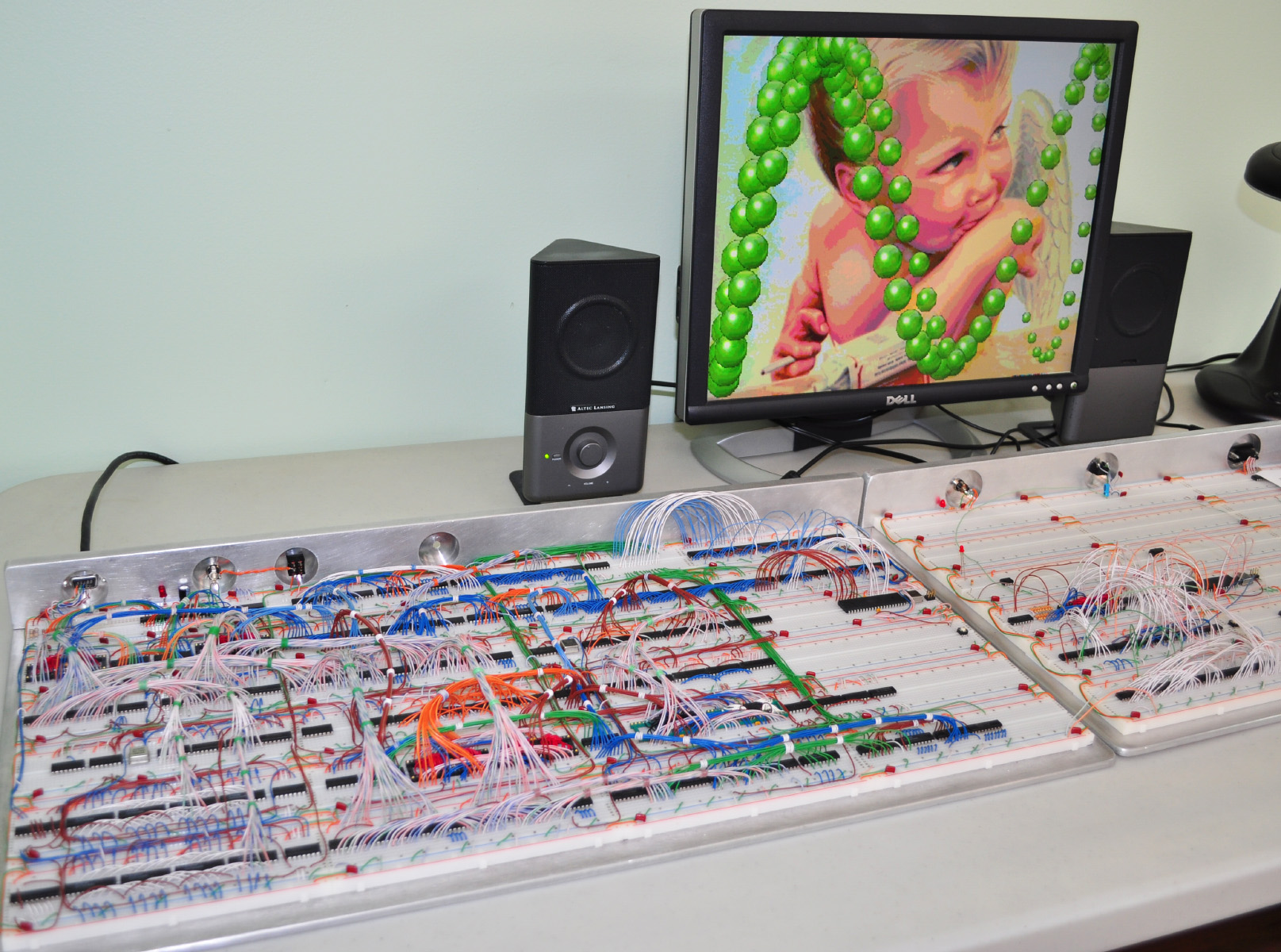

Yes, a full bitmap of that size would require 16MB, and since I am using 512K SRAMs, that would be 32 of them!
I do have addressing and IO pins set aside for that much, but only populated 2 MB (4 SRAMs) so far.
For my GFX test demo, I will create a Bitmap that is 64 times the size of the displayable PlayfFeld, and just make it a seamless tile.
Since my PlayField is 360x240, I will just use a 2880 x 1920 Bitmap, and repeat it to the full 4096 x 4096 available virtual screen.
Out of that 360x240 displayed PlayField, a standard TV or Monitor displays about 320 x 200 before seeping into the overscan area.

Not much basement time lately. It's harvest season, so I use a pitchfork a lot more than a soldering iron these months!
I did manage to prototype the logic for my theoretical "Amiga Killer" color generator, and wadda ya know... it worked!
4096 colors?... yeah, that used to be a lot, but my VIC-20 can do 8192!
What is shown above is a standard TV displaying 32 rows of different colors (CHROMA) , each with 256 brightness levels (LUMA).
The image on the TV is only 256 x 200, but that is because I decided to use only 8 bit counters to draw the frame (for now).
The top band is black and white, created by sending no chroma data for color number 0 of 31.
The entire circuit is running from the breadboard, and is using only 1980's style logic gates to generate the complete NTSC signal.
Timing is generated from the VIC generated video, with my new master Pixel Clock at 7.159MHz (14,318 MHz /2).
When complete, the new Video Enhancer will draw a 360 x 240 fully over-scanned image with simultaneous 8192 colors.
Since 256x32=8192, that means that the VIC can display twice as many colors as the Amiga HAM mode!
If y'all are wondering where the FPGA shown in the earlier photos went, well... I only use those to test basic theory.
The real project will be hand wired from ONLY 1980's style 74 logic gates. Modern tech. is highly over rated!
I probably won't get another hackin' day until winter, so here are the details on how logic gates make this magic real...

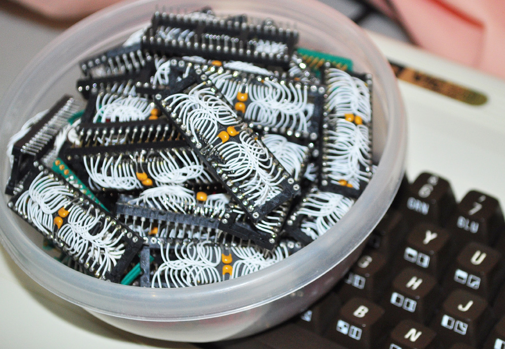

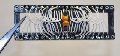

Re: VIC-20 JetPack [split from: VICE Build and Mods]
At least 300, perhaps 500!
Here is just the Video Generator part of the unit I prototyped a few years ago.
I ended up filling both boards, and that alone was 200+ ICs.
That unit was VGA, which is WAY easier to do than NTSC, which I am doing now.
That unit only did 256 colors, and now I am also doing 8912 colors.
My new system will have 16MB of SRAM, that one had only 4MB.
The new design is going to be MUCH more powerful.
My goal is to make the most powerful 8 bit computer ever designed (using of the era components).
Of course, the VIC-20 will be the host of this power, as it should be!
