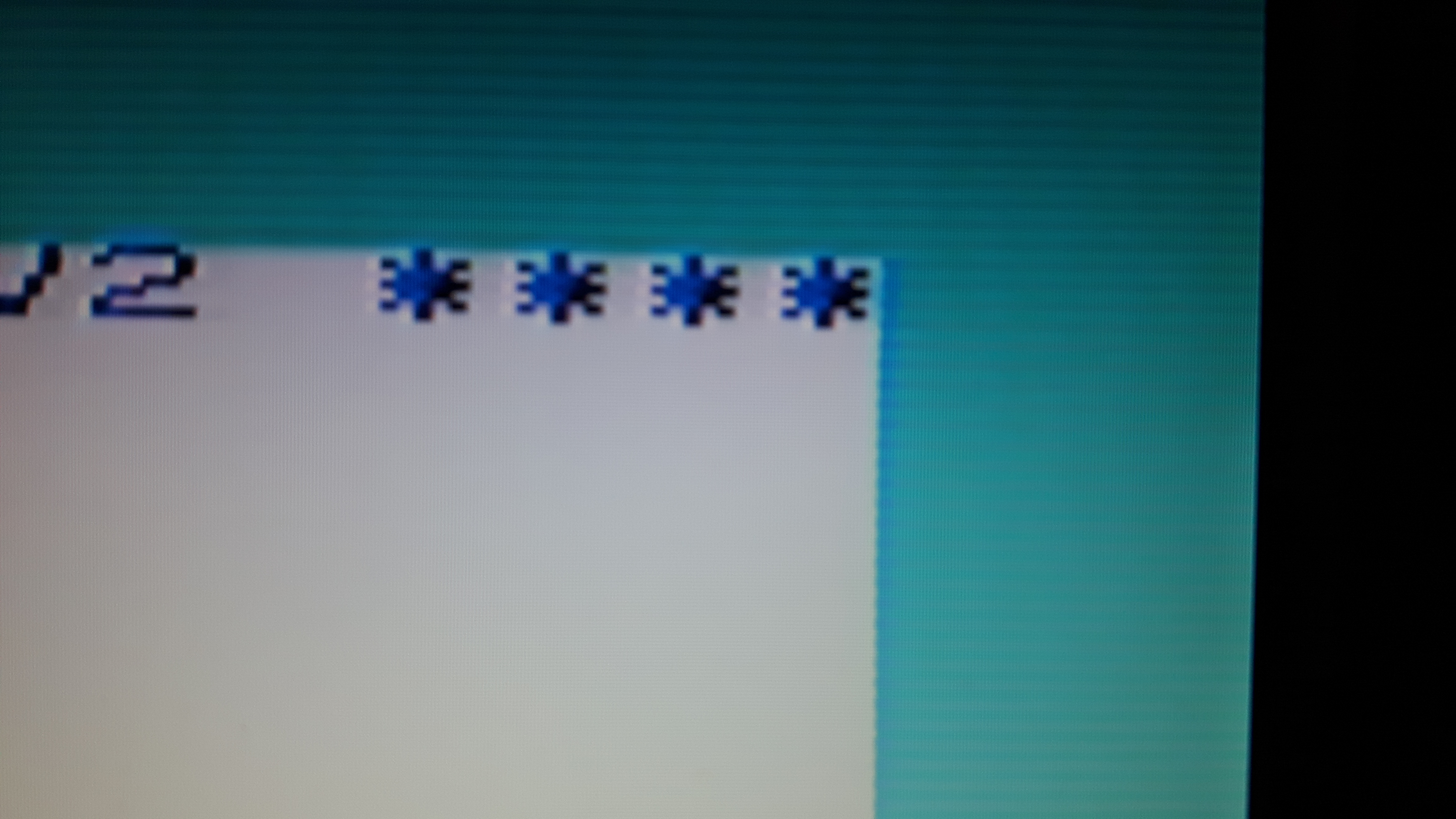

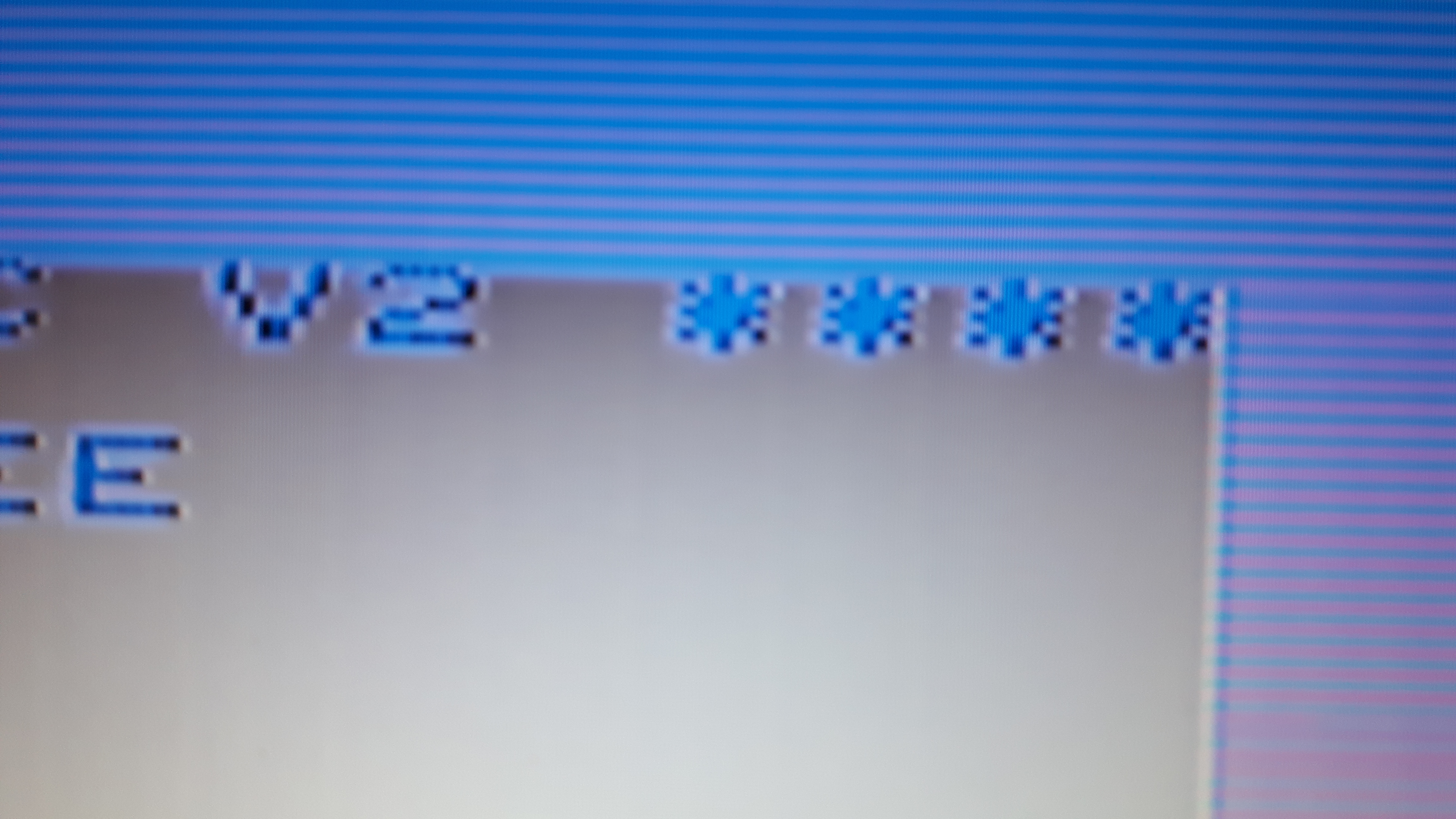

Re: Display issue
This first picture is my old two pin system
This is the CR system
They are both PAL.
They are both PAL.

Re: Display issue
Ah, horizontal lines!
For some reason I was thinking vertical lines.
I wonder if your 4.436MHz color carrier is off a bit?
In PAL, every second scan line has the color phase inverted as an attempt to reduce errors.
Seems you are getting one good scanline, and one bad one.
I only have NTSC VICs, but I know you can slightly "tweak" the input clock.
On NTSC, the base clock is 14.318, and then divided internally by the 6560.
The 6561 uses the PAL color carrier frequency directly as the input clock.
So your clock is 4.436MHz, or at least it should be.
On an NTSC system, this puts the color out pf phase, working like a "hue" adjustment.
On a PAL system, it may account for what you are seeing there.
Have you probed pins 38, and 39 on the VIC chip to see what the input clock frequency is?
