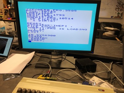

After a s...load of debugging I have finally made a source that can load programs from the SD card. Using sourcecode from another project was not the smartest way to do this, so I ended up remaking alot of it.
Anyway, here are some pictures:
Initializing a 8GiB SDcard takes 2-3 seconds. Smaller cards are faster. This is what the actual card requires to initialize memory and has nothing to do with the SPI interface or 6502-side software.

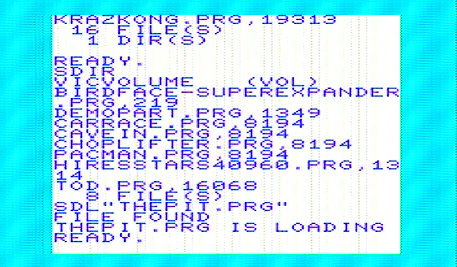

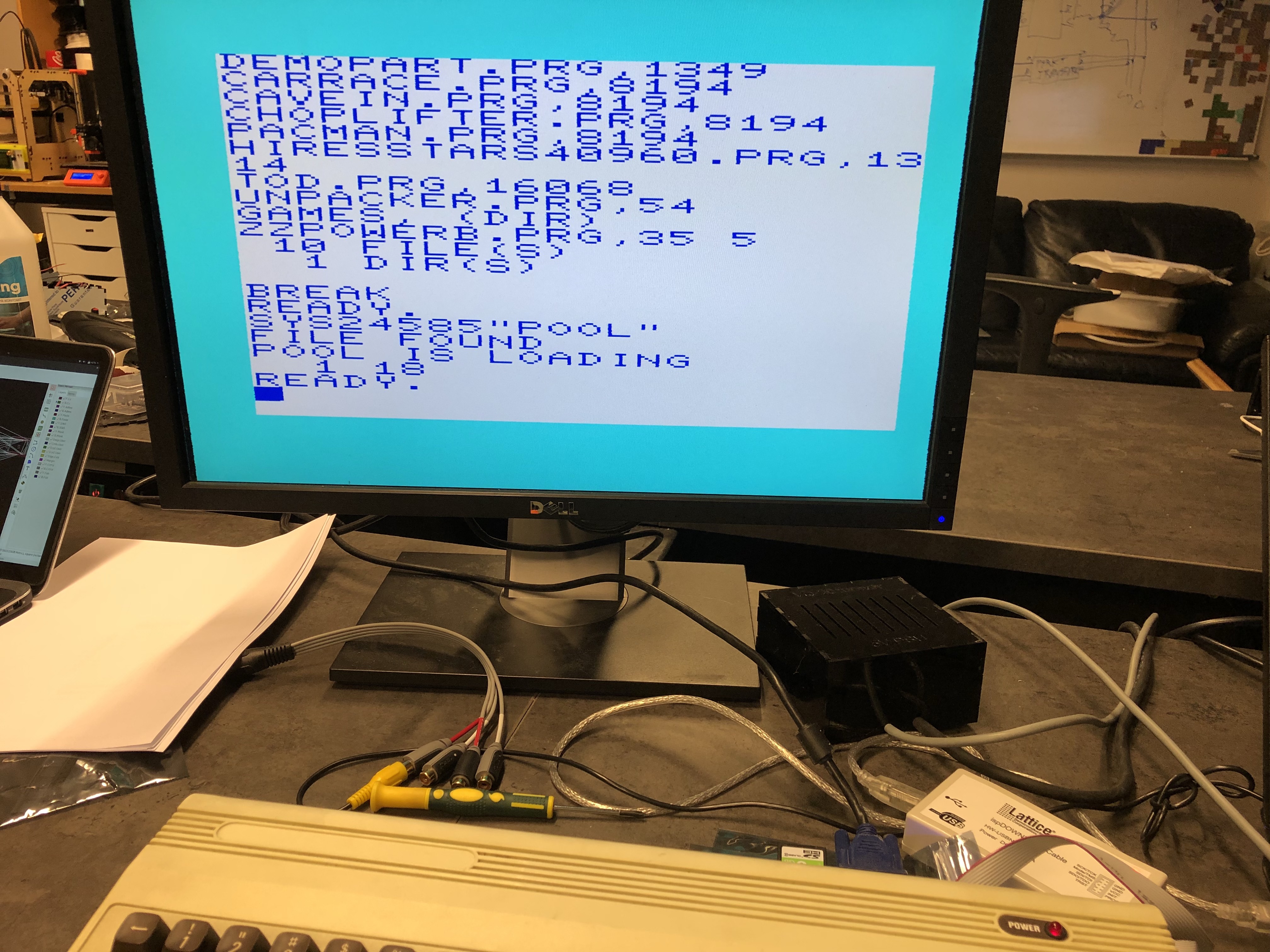

Displaying a rather large directory. RunStop works. Another SYS command to load a program. "POOL" did not start for some reason. Probably related to Basic pointers or something (will debug that).

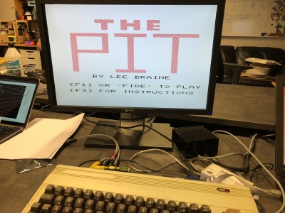

Loading "The Pit.prg" instead. Loading of 10KiB takes a few milliseconds. It looks instant.
The Pit runs fine. Its a ok game. :roll:

I have been playing around with a menu (not finished) and a basic extension. Currently SD card commands have been finished:
SDIN (or SDINIT if you want to used the full name):
Commands have been tested to work in both immediate mode and as part of programs. Seems to be ok.
SDIR:
SDLOAD (or SDL for short):
With the current menu (which I will show you soon), the total code size is around 14KiB which fits nicely inside the flash memory of the MachXO3. I will keep you updated as things proceed.
