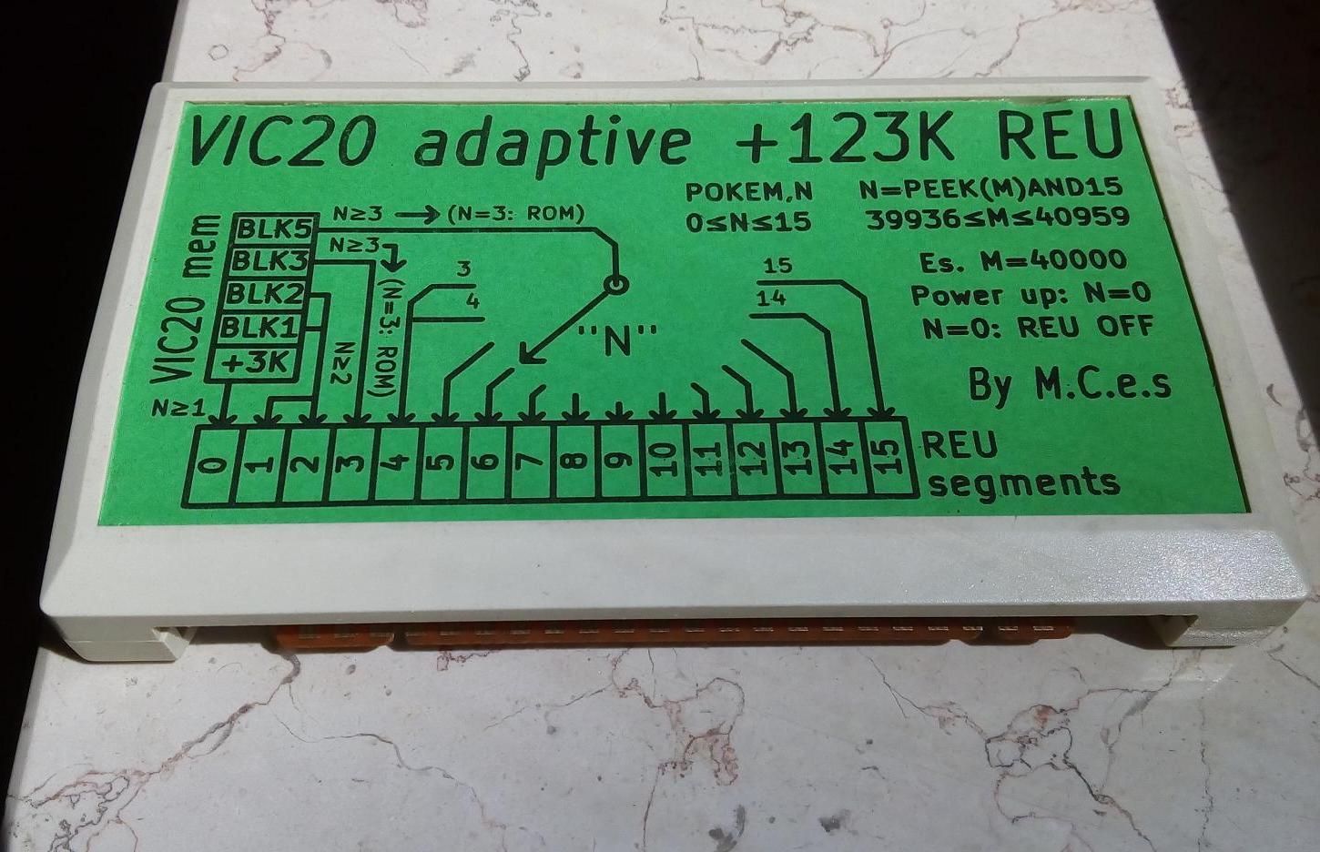

I propose a very flexible and powerful tool for your VIC 20,
it's a cartridge for memory expansion that is configurable via an internal 4bit PIO.
PIO is located in each address from 39936 to 40959 (for simplicity '40000') and it's Writable and Readable,
so the cartridge could be also DYNAMICALLY reconfigured by a running software.
At VIC20 startup you type "POKE40000,N" with 'N' that means:
0) unexpanded configuration (default at powering up)
1) +3K (RAM1+RAM2+RAM3) {+3k(Basic)}
2) like '1' and more: +16K (BLK1+BLK2) {+3k,+16k(Basic)}
3) like '2' and more: +16K WRITE PROTECTED (BLK3+BLK5)
4) like '3' but without the write protection of BLK3,5 {+3k,+24k(basic),+8k}
5..15) like '4' but BLK5 is re-addressed in another of 12 "RAM expansion segments".
So cartridge could become every expansion that you need and/or the memory support of a software that can dynamically chose a 8k page in BLK5 from a 12*8K=96K memory space .
After "POKE40000,N" you can type SYS64802 to restart the operative system of VIC20 for recognize the new memory asset.
PIO is readble with "PEEK(40000) AND 15"
Price is 44€ +shipping (PayPall gift)

Impressive indeed :shock: . Like the label very much, too.
Just asking: what real use for it? Is there any existing software for VIC dynamically using more than 24 (+- 3) kilobytes of RAM?
Great techie stuff anyway!

The cartridge into the pic is the real object and it work like described.
This cartridge is a my project: now don't exists a SW that use this paging but this feature is available for a owner program.
Do you want to load a game that don't work on normal RAM in BLK5?
Put the cartridge and switch-on your VIC20, type POKE40000,4 then load the game: LOAD"dumped game",8,1 then type POKE40000,3:SYS64802 and the game will auto-start correctly.....

This cartridge is composed by 2 chips:
the first is a 128K SRAM,
the second is a Programmable-Logic-Device that implement a 4 bit PIO and a Memory-Manager-Unit.
Tomorrow evening I'll try to make a video

The goal of my project is to be adaptable at what you need:
do you want a +3k for the relative memory configuration of VIC20 operative system? yes!
do you want a +16k/24k for the relative memory configuration of VIC20 operative system? yes!
do you want a +35k ? yes!
do you want a RAM expansion (with possibility of "Write-Disabling") to load dumped cartridge images with presence of other RAM free for data (example: loading image of LM or BASIC tools cartridges) ? yes!
Do you want to hide a SW (or DATAs) in a pagined BLK? 12 times yes......
It could be every kind of RAM expansion do you need, it's a simple HW-TOOL for improve ( adaptively ) the configuration of your VIC20 without denaturalize it!
I had to sacrified a cartridge for this: the object into the PIC is what I'm selling, case included
