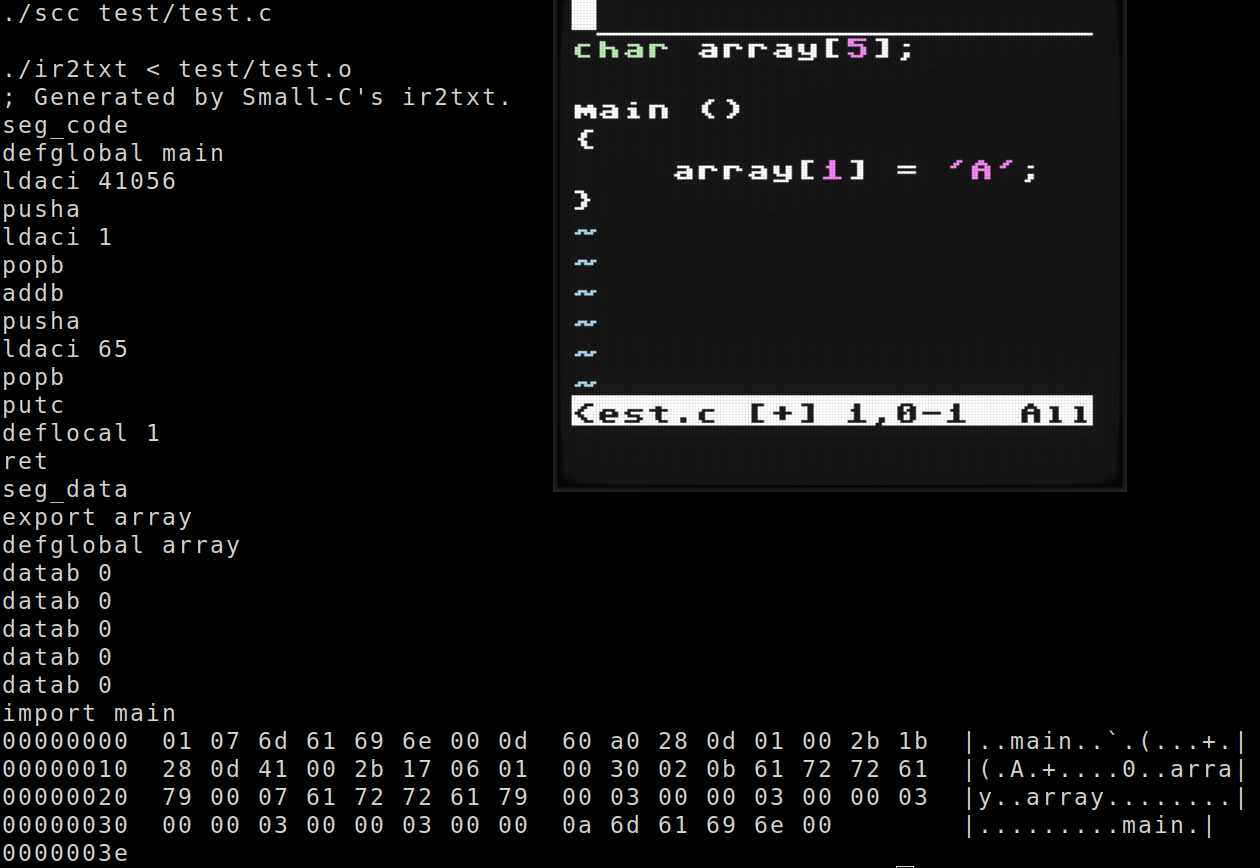

But take a look at this:
The tiny C fragment got compiled to byte code at the bottom which the 'ir2txt' program translates to the pseudo-assembler to the left and that just needs to run through a set of asm macros that does the targeting. No boring with details (yet). Both formats offer quite some playground and grow room. Hard-targeted asm generators should give everybody the curlies. Source lines and symbol info could also stream in just in case somebody wants to wedge in an optimizer later on.

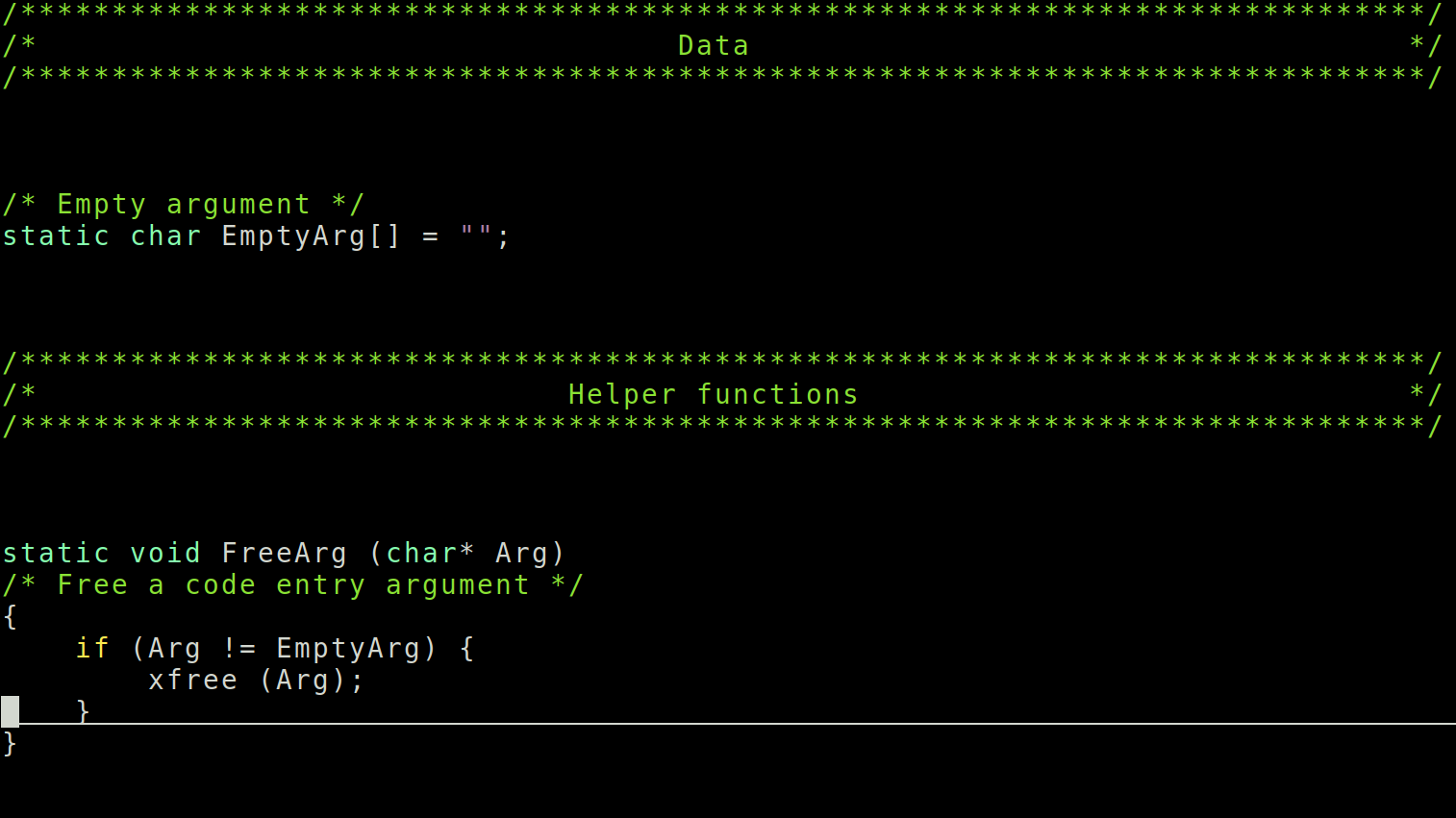

That's a lot of lines for declaring an empty string and an "if". What's the name for this in the "bad code" glossary other than "bloat"?
