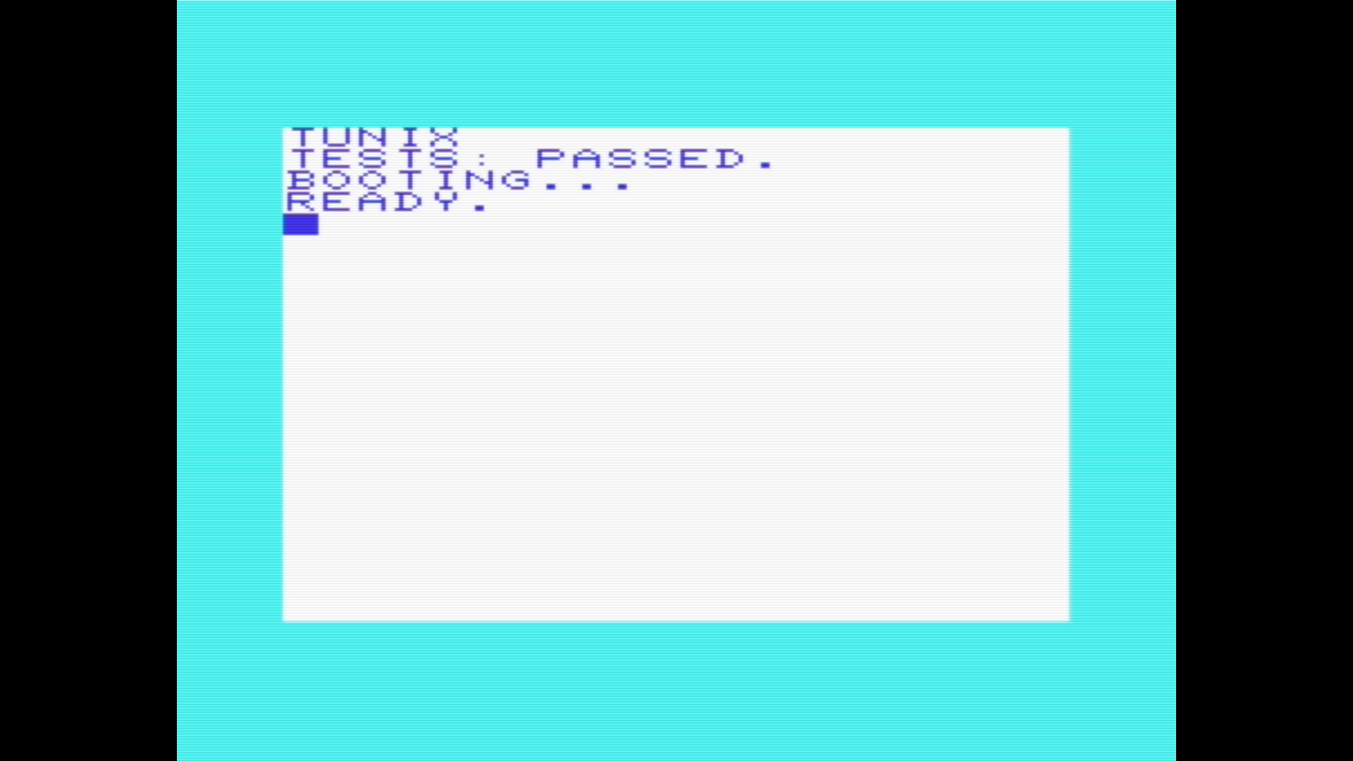

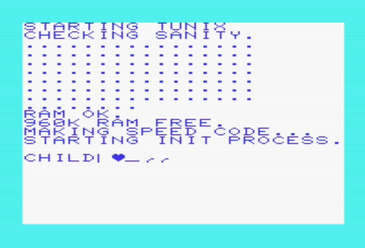

First boot. Meaning userland C coding. :mrgreen:
