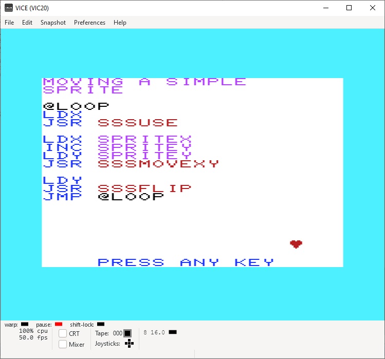

here is the picture . . .

The glitch in the graphic display is happening at the point the SSS switches to the other screen in the double buffered display. I don't yet understand why it switches at that point, but I think it has been deliberately chosen: perhaps to allow enough time to rebuild the whole screen before it appears at the top of the display. The glitch disappears if the vsync occurs a few rasters later. You can see this if you change the raster line value from $76 to $80 in the basic file line 67 (assuming PAL system).
Thanks for pointing the issue out. I hadn't noticed. I'm not sure yet whether or not the issue is a feature of the SSS or the conversion. I have noted it and perhaps the cause will reveal itself when I have a better understanding of how the SSS works.
