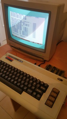

Hi everybody,
Time passes and our beloved Vic-20 begin to age... I had a problem with a my VIC so by searching on the net I've noticed there is a lot of interest on diagnostic tools (software and hardware) but for a reason or for another nothing sodisfied me.
At the end, I've written some Diagnostic tools and modified/hacked others and I think they could be useful for other Vic-20 users too.

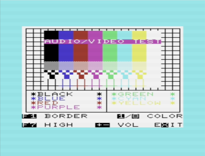

Vic Audio/video Test:
Inspired by a German Color Test cart image found on Zimmers, I've "adopted" a bit the screen pattern and written a similar utility with additional audio test that works for unexpanded VICs

This is a program for unexpanded Vic similar to the extended keyboard test of the Diag264 cartridge for C16/Plus4, it displays the Vic-20 Keyboard matrix and you may type all keys to check them:

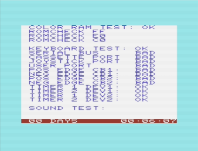

Vic-20 Diagnostic Tool:
I hacked the NTSC version to work on PAL machines too (unique version for both PAL and NTSC).
This version also works without harness adapters (marking the external port tests as "BAD" of course) but without interrupting the test cycle so at least all the other tests (RAM/audio/video/etc) work in loop without problems, more technical information on Zimmers.

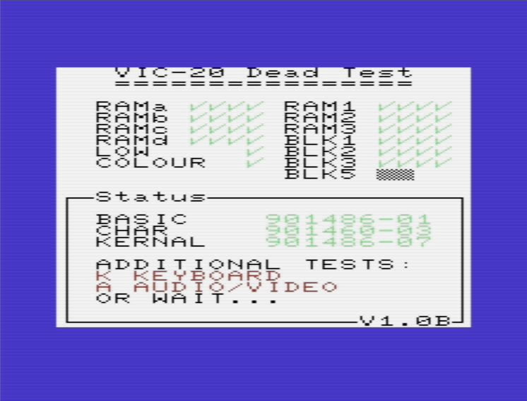

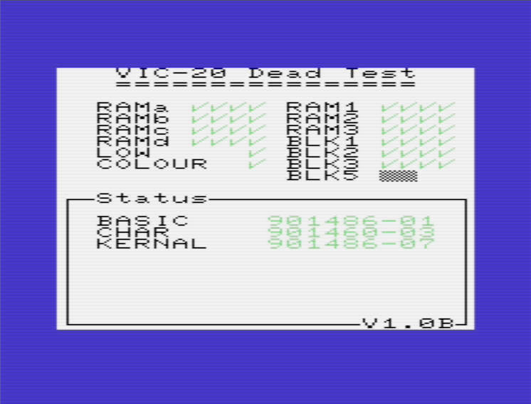

Vic-20 Dead-Test:
Starting from this Git project derived from this other, I've released a 1.0B version that executes all tests in loop and proper work in RAM for NTSC machines, the 8k version includes my keyboard and Audio/Video tests too.
Please note that if the VIC as some problems it can only starts from a cartridge, this because it does not use any kernal call.

Excellent! I was wondering how to use the dead test on a dead VIC in fact... Slapping it on the Mega Cart start menu will be great. Otherwise, a dedicated Jolly Cart (Mces) would come handy.
Re: Diagnostic Tools for the Vic-20
I was planning to make my dead test support being an EPROM inserted as a replacement for the KERNAL ROM. That way it is usable even when the system is unable to boot to an external cart. Running an image in BLK5 requires a (short) bit of code in the KERNAL, if it's defective you can't start anything attached to the cartridge port.

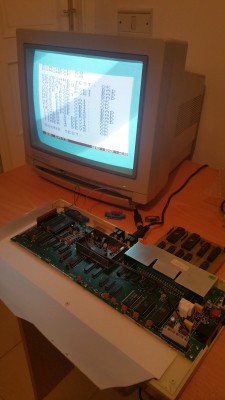

Thank you for this! I've made a couple carts for future repair work. My VIC-20 in current rotation is getting stuck on the diagnostic program, which I'll have to look into.
