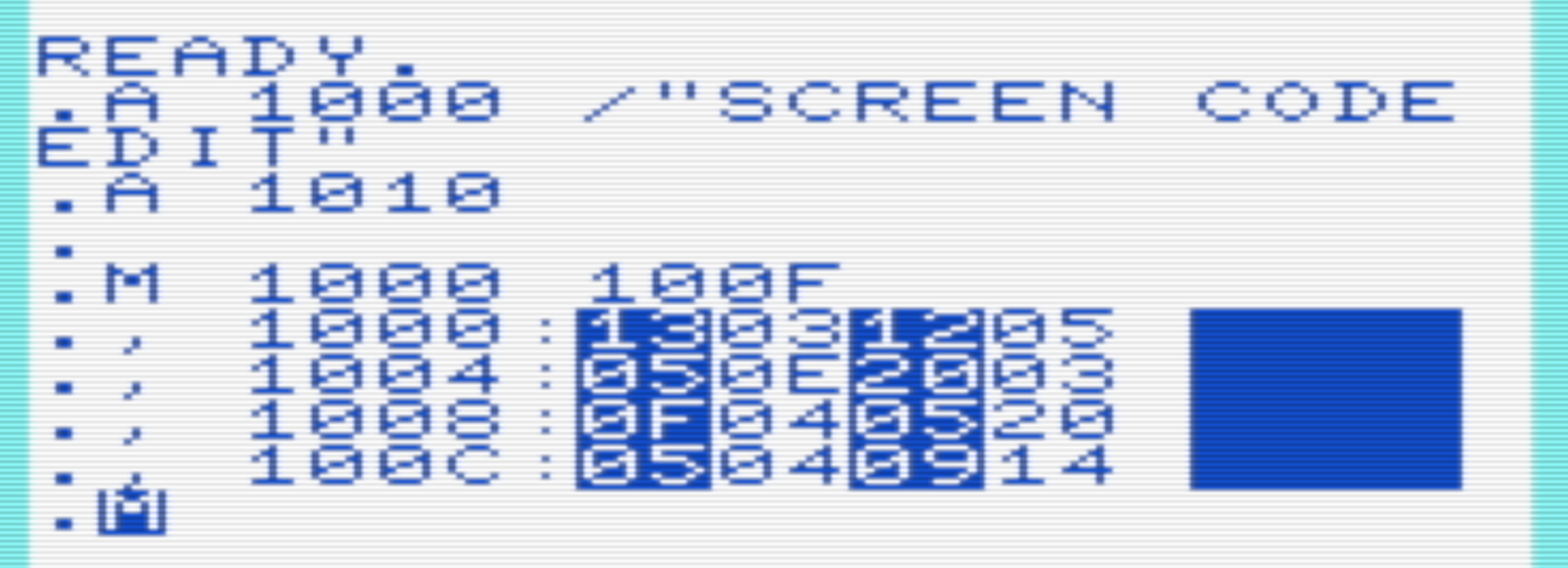

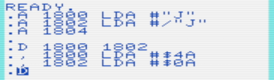

With the latest update, a slash before a quotation mark will put screen codes into memory instead of PETSCII values. This works in any memory editor that uses quotation marks:

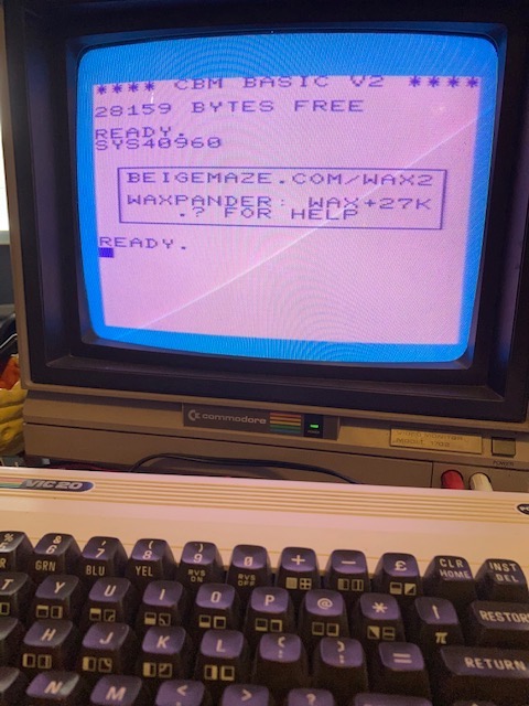

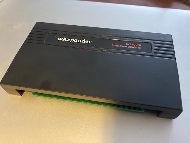

Here's the first wAxpander cartridge!
I haven't quite decided how to do the reset button yet, but I want to make it available. I've consistently cracked cartridge cases in the past by putting in reset buttons. I might have more luck drilling a hole on top, next to the label.
Everything's on the table. I even considered just having a couple wires hanging out the slot in the back that you touch together. That seems classy.

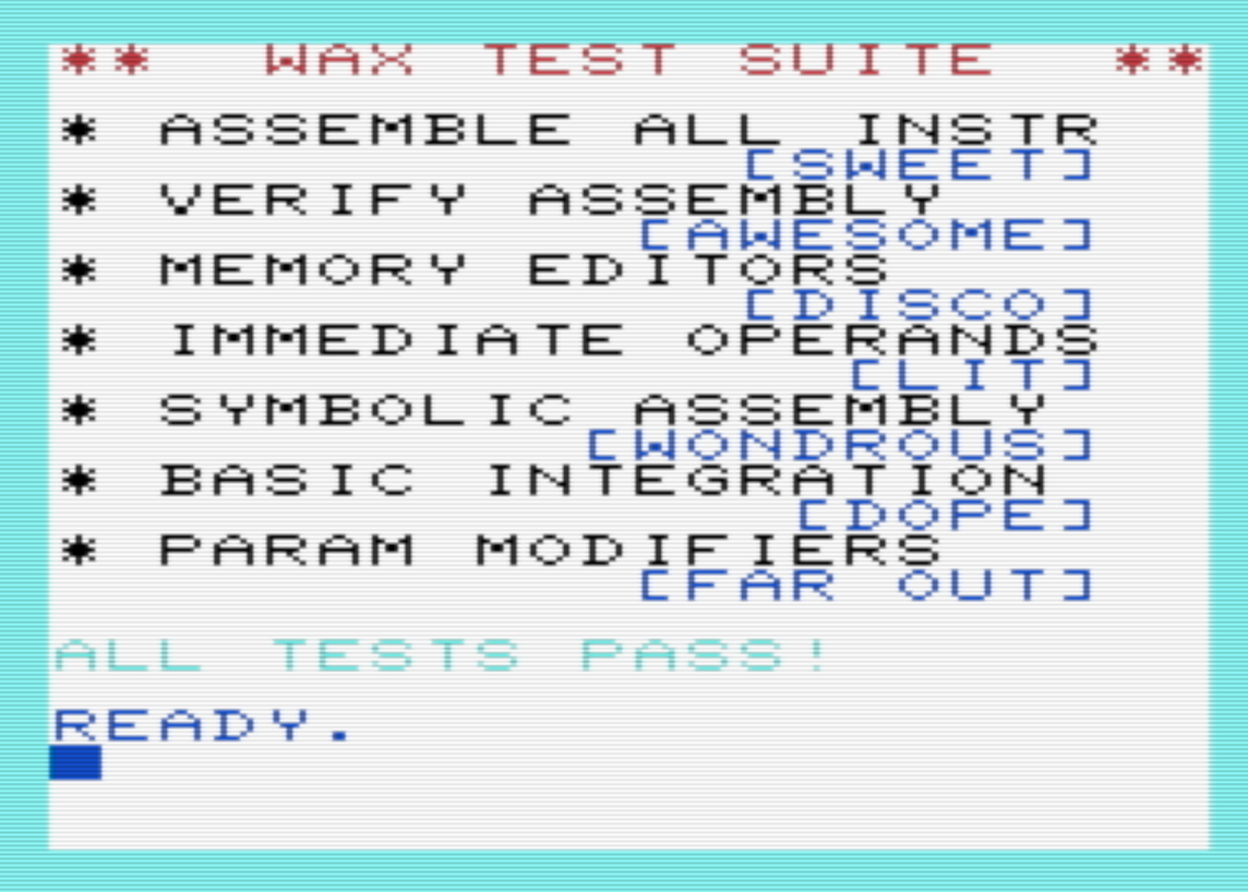

The extra 24K of memory makes the wAx2 test suite way easier to deal with. Originally, it was written for an unexpanded VIC, and it had to be broken up into a different BASIC file for each test. Now I can put all the tests in one file, having plenty of room for the tests and the data they generate.
In the original wAx, I ran the test suite with just about every change, and now I can start doing that again. It tests every addressing mode for every instruction, and every kind of syntax and assembly feature. Each test involves entering code or data, and then using the wAx "=" tester to make sure the data is as expected. The original 6502 instruction test was made with XA, using XA's output as the test data, to keep test data independent of wAx's assembler. Just in case something goes wrong.
The new test suite adds tests for arithmetic, substitution, screen code data entry, and the new BASIC-mode variables.
This has already caught two sneaky regression issues, one on immediate decimal arithmetic, and one on screen code entry. So I'm happy.

I thought I found the perfect reset buttons. They're just the right size to poke out of the slot on the back of the cartridge without drilling any holes. I can just epoxy them into place.
But instead of receiving my buttons, I received a pack of 100 "Data Phone Wire Butt Splice 3 Ports UR Connectors." I don't even know what these things are and Amazon doesn't want them back. They're probably not recyclable. And the buttons I wanted won't be back in stock until the end of March. Also, I have no way of knowing whether I'll simply receive another pack of whatever these damn things are!
It's like instead of getting the atomic bomb you wanted, you get a shoddy bomb casing full of used pinball machine parts.
Gah! Back on the hunt....
Update: I found a tact switch assortment that contains the ones I wanted. There aren't as many of them, but at least I can stay on schedule.
