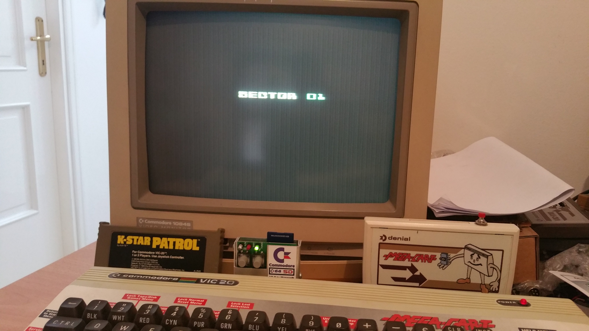

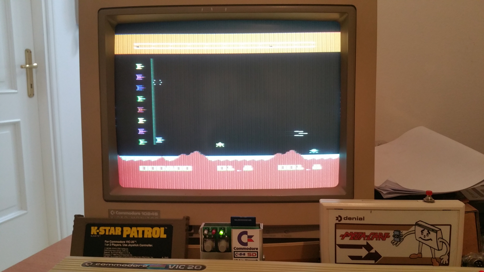

I've just received the original cartridge and as suspected it was an NTSC-only game and it does not work on PAL machines, not only off centered but when you start the game, it hangs on Player 1/2 mode selection.

Some Picture taken from Real PAL Hardware:

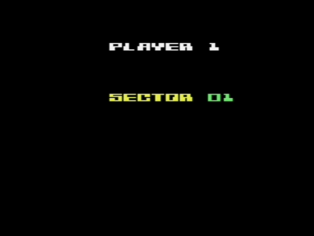

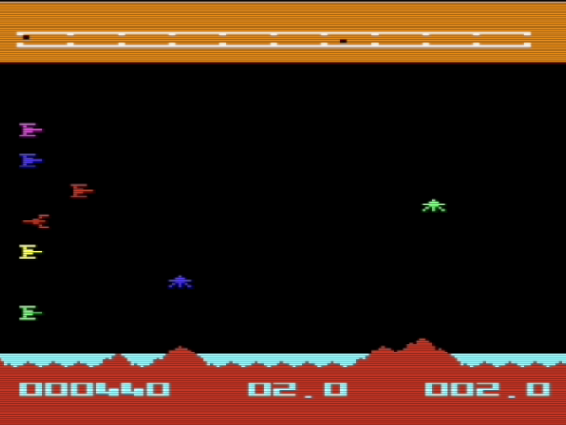

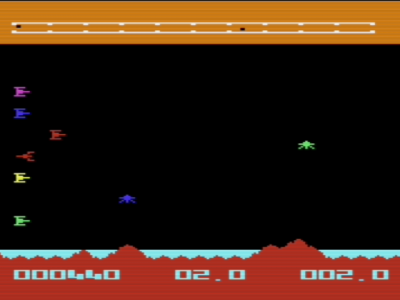

Here we are !
As promised, I've attached my new dump files of the original NTSC version of K-Star Patrol (Ram protected) and there is also a RAMFixed version of BLK3 Rom for NTSC and PAL that has a raster fix too.
