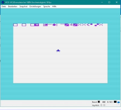

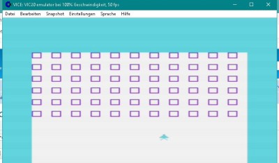

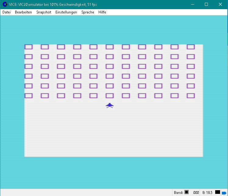

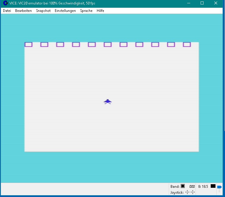

Posts: 241
Joined: Tue Sep 10, 2019 4:23 am
Re: V-FORTH - Forth-83 for the VIC (Vforth.rom)
Post by funkheld »
Hi good afternoon.
why is the first row with the pattern not displayed correctly with vforth?
Thank you.
greeting
variable xb
variable yb
variable pw
variable sw
variable cw
variable charbase
5120 charbase !
8192 constant ramhi
32768 constant charset1
create mu
1 c, 32 c, 1 c, 32 c, 1 c, 32 c, 1 c, 32 c, 1 c, 32 c, 1 c, 32 c, 1 c, 32 c, 1 c, 32 c, 1 c, 32 c, 1 c, 32 c, 1 c, 32 c,
create daten
24  c,  24  c,  60  c,  126  c,  255  c,  24  c,  36  c,  66  c,
255 c,  129  c, 129  c,  129 c,  129  c,  129  c,  129  c,  255  c,
: redefset
charbase  @  ramhi  over  -  cmove
charbase  @  charbase !  ;
: muster
506 0 do 4 i 37888 + c! loop
506 0 do 32 i 4096 + c! loop
22  0 do mu i + c@ 4096 i +  c! loop ;
: cls
511 0 do 32 i 4096 + c! loop
0 0 $plot ;
: ti 200 0 do loop ;
: set
yb @ 22 * xb @ + pw !
0 sw @ pw @ + c!
6 cw @ pw @ + c! ;
: lin
xb @ 1 - xb ! xb @ 0 < if 0  xb ! then set ;
: rec
xb @ 1 + xb ! xb @ 21 > if 21 xb ! then  set ;
: obe
yb @ 1 - yb ! yb @ 0 < if 0  yb ! then set ;
: unt
yb @ 1 + yb ! yb @ 22 > if 22 yb ! then set ;
: farbe+
fb @ 1 + fb ! fb @ 7 > if 7  fb ! then set ;
: farbe-
fb @ 1 - fb ! fb @ 0 < if 0  fb ! then set ;
: gehe
charset1 redefset
205 36869 c!
16 0 do daten i + c@ 5120 i + c! loop
4096 sw !
37888 cw !
10 yb ! 10 xb !
muster
set
begin
ti
197 c@
dup 17 = if lin then
dup 18 = if rec then
dup 9  = if obe then

: muster
506 0 do 32 i 1024 + c! loop
264 0 do mu i + c@ 1024 i +  c! loop
506 0 do 4 i 37888 + c! loop ;
: schiebe
1024 4096 506 cmove ;
: cls
0 0 $plot ;
: ti 100 0 do loop ;
: set
0 sw @ pw @ + c!
fb c@ cw @ pw @ + c! ;
: lin
schiebe
yb @ 22 * xb @ + 4096 + c@  1 = if  xb @ 1 + xb ! then set ;
: rec
schiebe
yb @ 22 * xb @ + 4096 + c@  1 = if  xb @ 1 - xb ! then set ;
: obe
schiebe
yb @ 22 * xb @ + 4096 + c@  1 = if  yb @ 1 + yb ! then set ;
: unt
schiebe
yb @ 22 * xb @ + 4096 + c@  1 = if  yb @ 1 - yb ! then set ;
: farbe+
: farbe-
: gehe
charset1 redefset
205 36869 c!
4096 sw !
37888 cw !
12 yb ! 10 xb !
muster
schiebe
set
begin
ti ti ti
197 c@
dup 9  = if obe then
dup 41 = if unt then
dup 10 = if fb @ 1 + fb ! then  fb @ 7 > if 7  fb ! then set
    42 = if fb @ 1 - fb ! then  fb @ 0 < if 0  fb ! then set
?terminal
until  ;

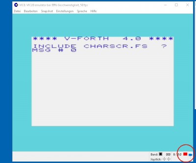

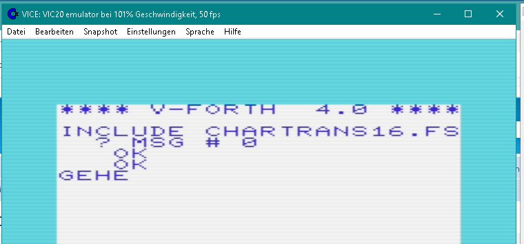

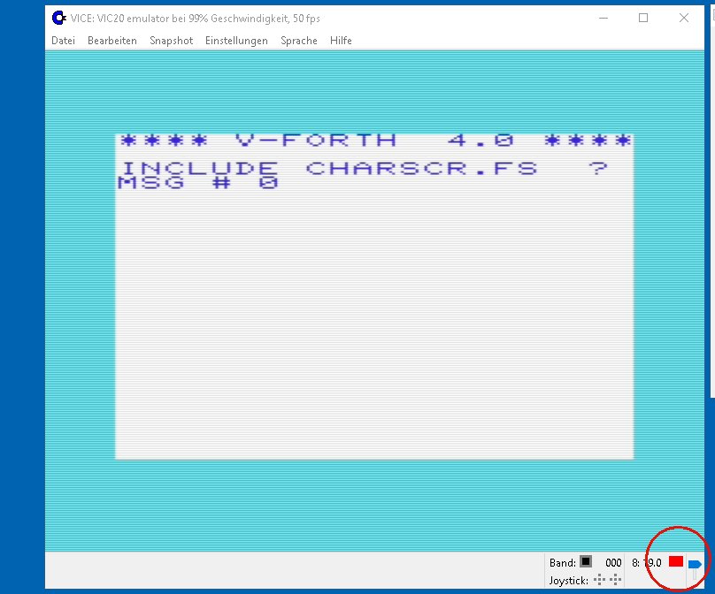

Hi good afternoon.
when i start include .... the drive does not turn off when the fs is loaded. (vforth.rom)
the forth programs always run without one
error message
Thank you.
greeting
VARIABLE CHARBASE
VARIABLE Z
5120 CHARBASE !
8192 CONSTANT RAMHI
32768 CONSTANT CHARSET1
: CLS
511 0 DO 32 I 4096 + C! 1 I 37888 + C! LOOP
0 0 $PLOT ;
: REDEFSET
CHARBASE  @  RAMHI  OVER  -  CMOVE
CHARBASE  @  CHARBASE !  ;
: GEHE
CHARSET1 REDEFSET
205 36869 C!
128 0 DO I I 4096 + C! 4 I 37888 + C! LOOP
BEGIN
KEY  DROP ?TERMINAL
UNTIL ;
Posts: 1349
Can you attach the file here?
funkheld
Posts: 241
Post by funkheld »
hallo, thanks.
this is the program above the picture.
greeting
