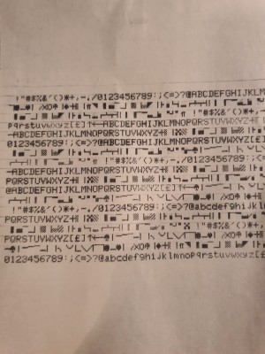

I just acquired a nice boxed MPS801.
It had a ribbon but it was very faint so I looked on Ebay and spotted the friendly German store selling 2 for over £40.
If I need some new ones I will be going to Alibaba I think.
https://www.alibaba.com/product-detail/ ... 2bcde4N3g8
In the meantime a quick tip.
I used a Parker Quink black ink cartridge, punctured it and squeezed and wound the ribbon.
It looks pretty good for just a few pence and was not very messy.
Here is a before and after shot.
Re-inking MPS801 ribbon

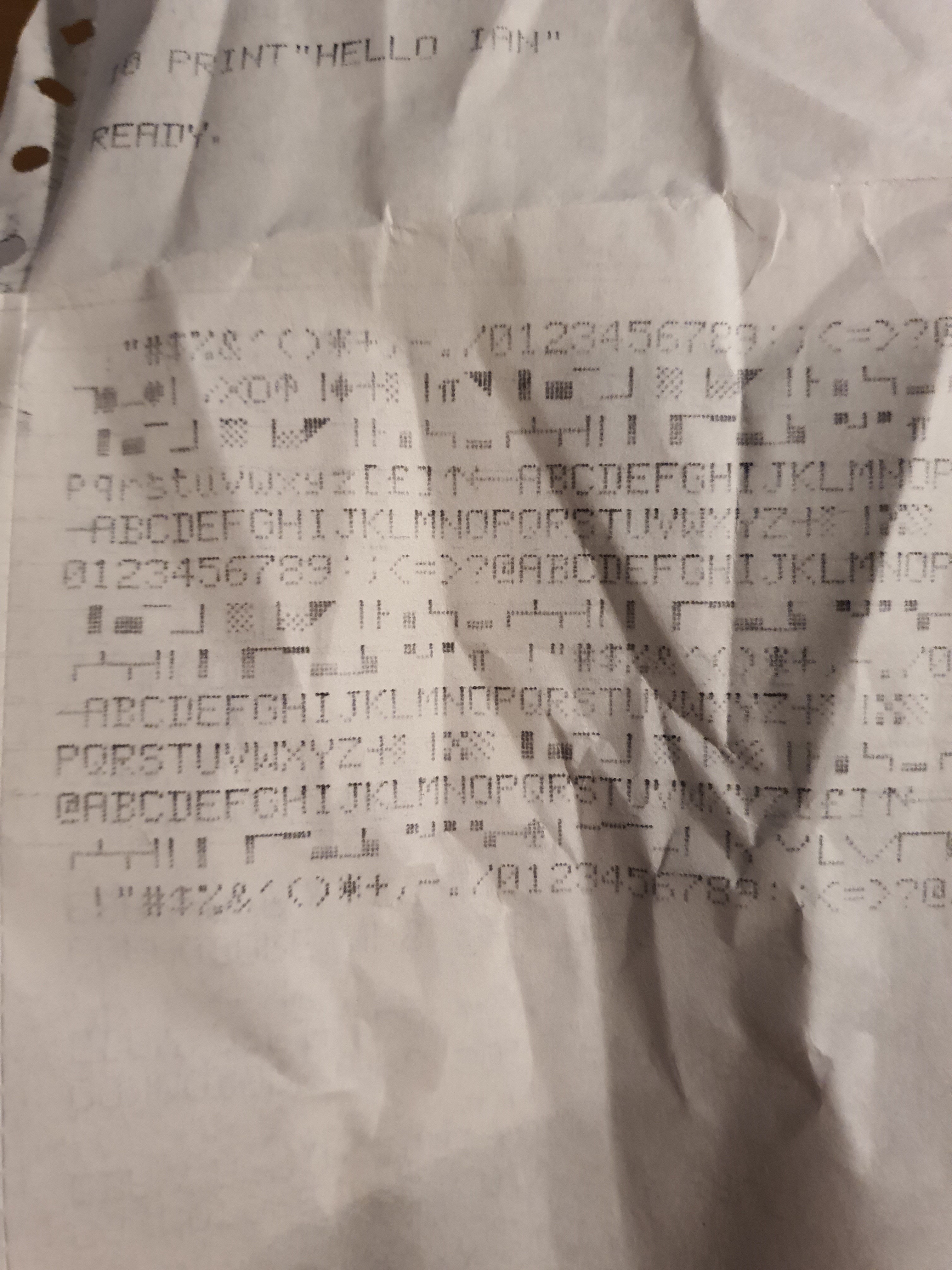

Re: Re-inking MPS801 ribbon
It was surprisingly easy and low mess until I finished and a small run of excess liquid leaked out of the side so I have a black thumb
Just keep winding and the capillary action and a small squeeze of the ink cartridge every now and then restores it well.
Some self test is needed to get rid of excess but in half a page it started to come out quite well.

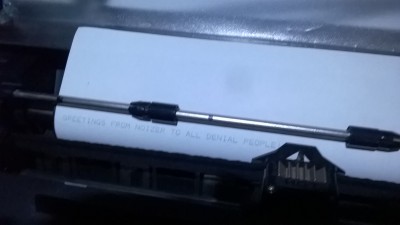

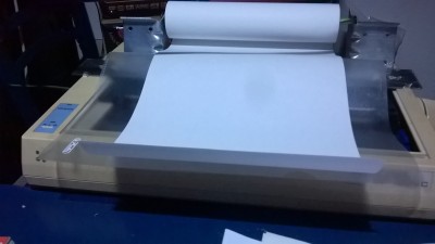

I've found a solution where my hands stay clean. Fax paper roll.
It no longer matters how good the ribbon is.
Maybe not good for business, but for some listing dumps IMO OK.
The fixation of the bracket is a bit tricky, but doable.
Look that. Is not the on original MPS801 but compatible SP-180VC. BR
