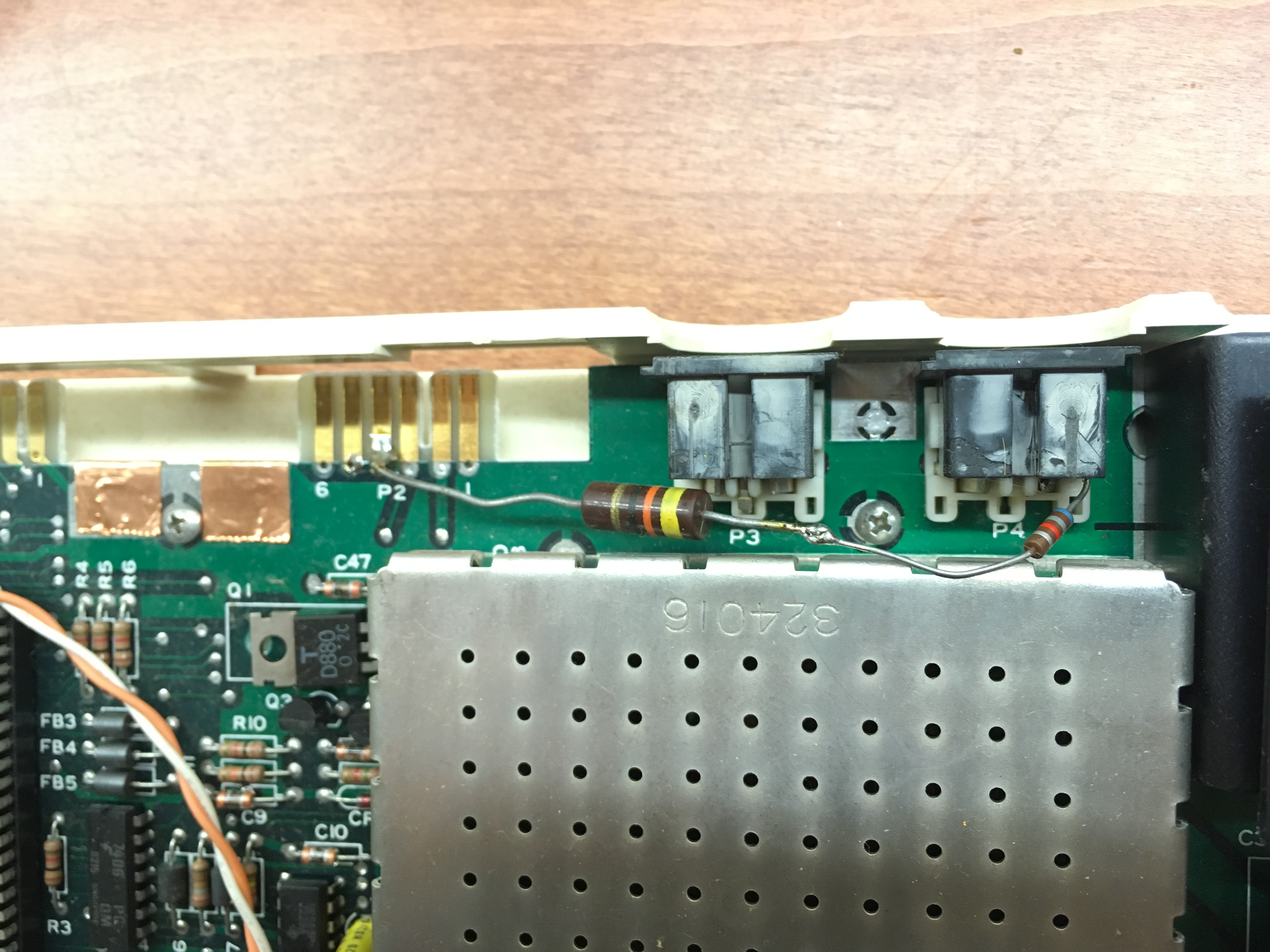

I opened up a VIC-20 (old board, ca. 1982 with the voltage regulator on the board). Someone had added two resistors in series between pin 4 on the cassette port and a pin on the video port. See attached pic.
I don't get what they were trying to do. Pin 4 is "read" and I didn't bother trying to figure out which video pin it was soldered to, just desoldered and cleaned up both sides. Any guesses what they were trying to do?

It's hard to tell unless we knew what video pin it was attached to.
But if it were GND, then maybe they were trying to create a pull-down resistor on the READ pin? Not sure why though.

Posts: 1342
Re: Resistors between cassette port and video port?
Looks to be connected to pin 3, the audio out.

ugly hack so you can hear whats being played on the datasette?

I did something like this back in the day as well!
I had one of the only VICs that could play real music, and do rhythm tracks for my lead guitar practice.
At one point my goal was to create a crude media player that could even catalog and find the songs on the tape based on how long it took to fast forward or rewind.
Mine had a switch though, since hearing actual tapes loading through a 100 watt tube amplifier is not cool.

Nice, Brad. I think that's the most likely answer. I'll check with my meter to confirm it is indeed pin 3 on the video port.
