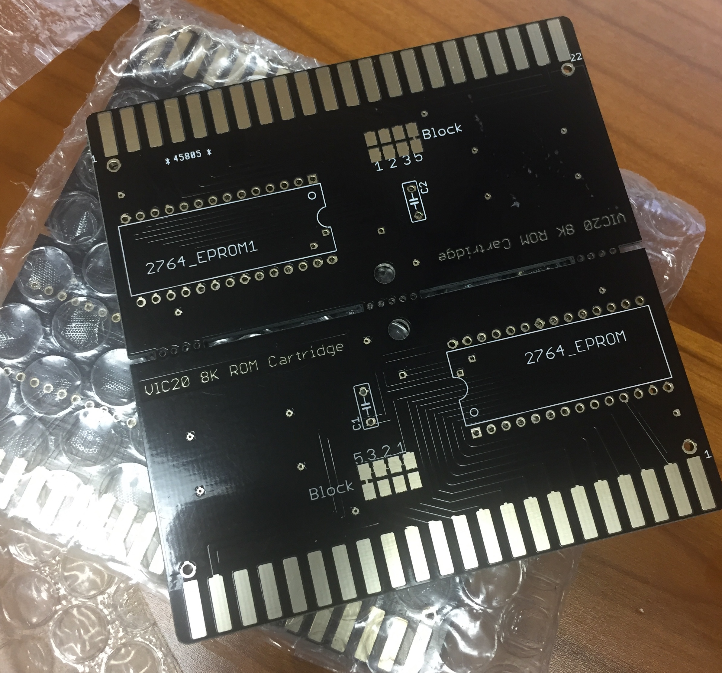

So, these arrived today:
For most of the people that hang out here this is old hat, but I've never done anything like this before. I've hardly ever soldered. :shock:
To me, these things look beautiful! Creating a Vic-20 cart is kind of a bucket list thing.

Re: My PCBs are here!
Post by Floopy »
Great...
A bit of advice: tape the sockets into position before you solder them, or else they will be crooked.

Posts: 5458
Floopy wrote:Great...
I bend pins 14 and 28 instead.

IT WORKS!
The last component I needed, solder of all things, arrived from Amazon today, so...
I soldered an IC socket and capacitor to one of the new boards. Then I dl'ed Attack of the Mutant Camels from zimmers, deleted the first two bytes and burned it to an eprom with a cheapo eprom programmer. Plugged the eprom into the socket, stuck the card in the slot and turned on the Vic-20. The game loaded right up!
Every piece of this project is something I've never done before. Many thanks to norm8332 for providing the PCB files and all the steps to get them ordered. Thanks also to others who gave tips and advice, I used all of it. I learned a ton from this and it was very satisfying.
