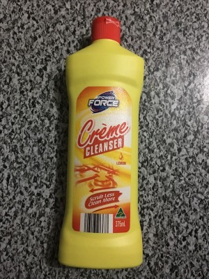

Could you be more specific as to what "Creme Cleanser" is? A brand, a picture, a... chemical ingredients list?
And maybe how you applied it (scrubbing it, soaking it for a few hours, ...) I've tried several things, but nothing seems to help.

I just saw your post by chance, so a bit lucky there. I noticed the same thing, if You put them in water they look great until they dry out again.
Here's a photo of what I used, it could also be called scouring creme elsewhere.
I just put some of this onto a clean rag and polished the colour back in. It is a fair amount of work, but 1 key only won't take long.
